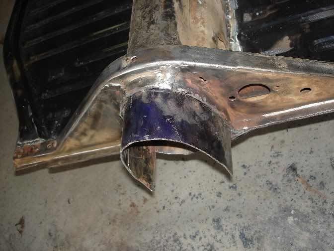

I am going with a 6" wider beam, Disc brakes Bilstein shocks and I don't know what else Very Happy
I cut the frame head off last night. It was ugly inside.
It was cracked REALLY !! bad.
I then smoothed out the remaining area and just for a test fit I put in a small piece of tunnel steak.
My assistants Very Happy
I am planning on welding here...
And here of course..
I held the new frame head in place just to get a look at what I need to do next.
Any suggestions?

I got the frame head mounted today !!!!
Here are a few more progress pics.
I started by drilling some holes in the tunnel to use as plug weld locations
Then it was time to start attaching the frame head.
Just for fun I mounted the new beam... I like it.
