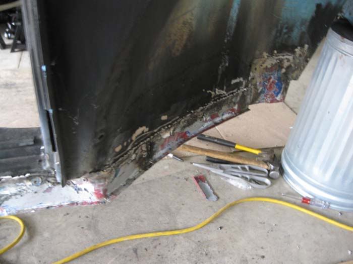

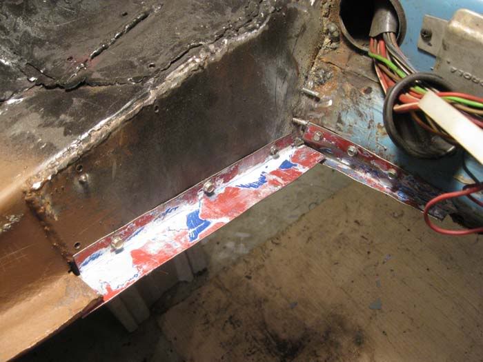

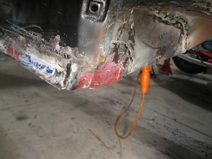

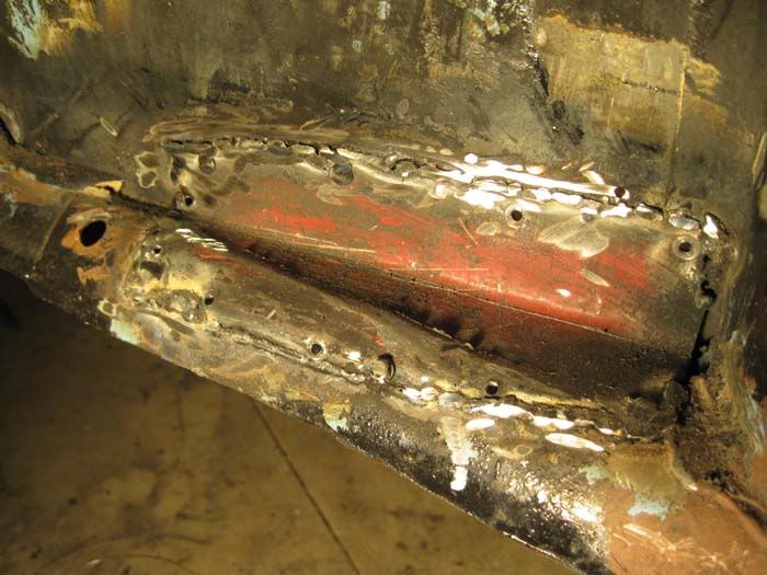

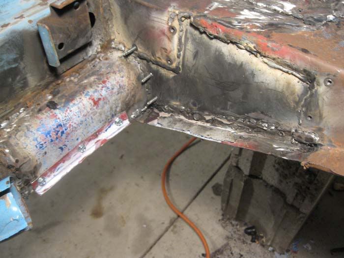

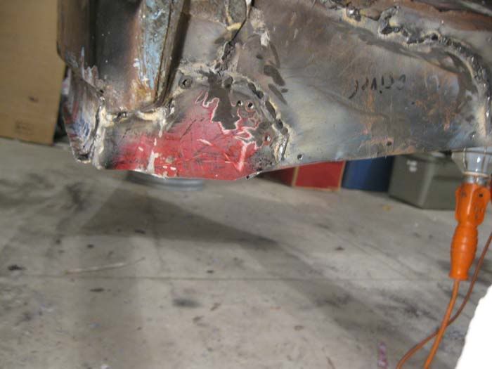

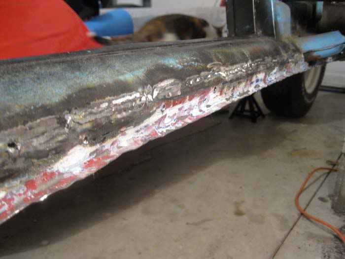

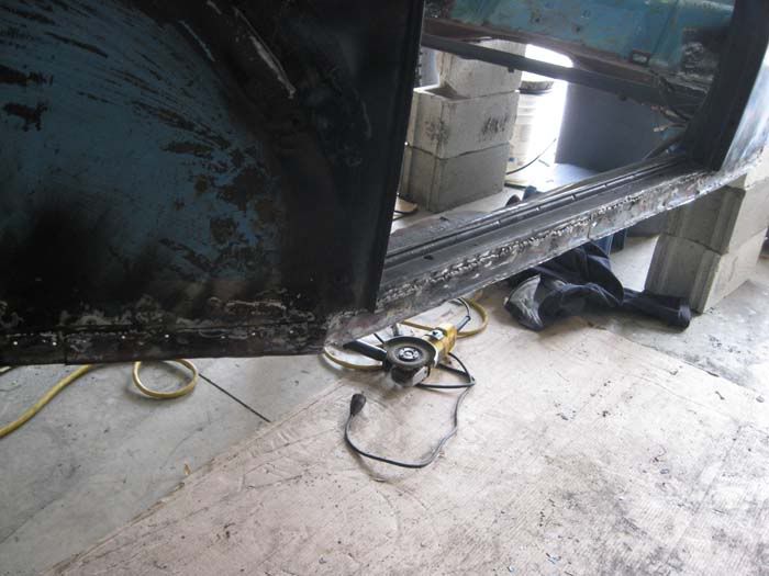

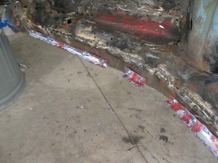

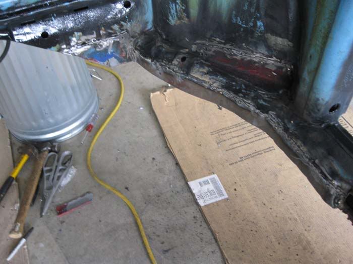

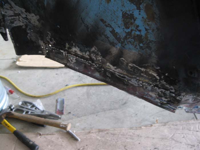

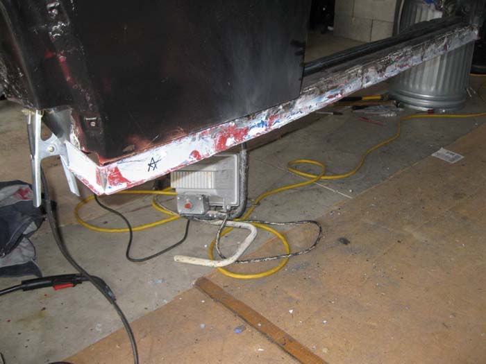

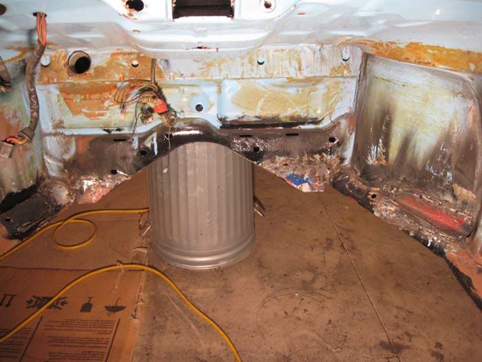

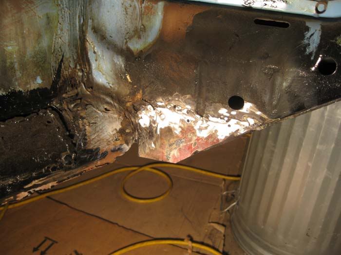

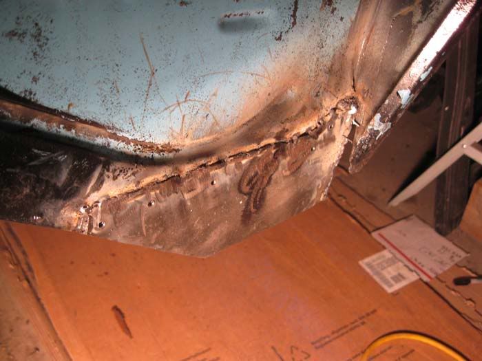

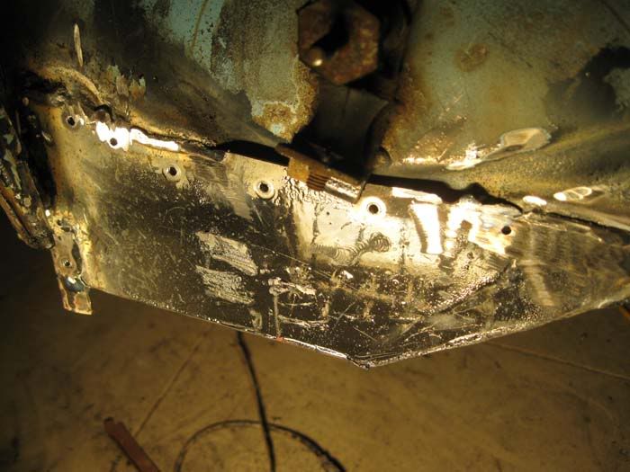

i got alot farther than i was hoping this week and now i have all the patching done and the heater channel bottoms welded on.
*all these pictures are a couple weeks old ill post recent ones of the finished work in a couple if days*

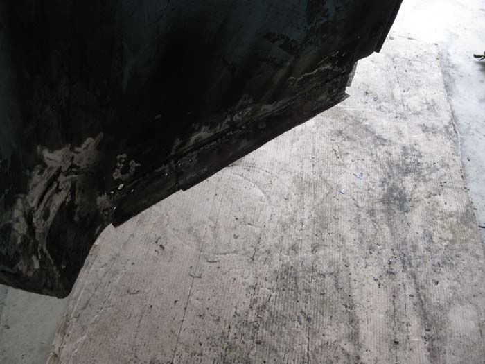

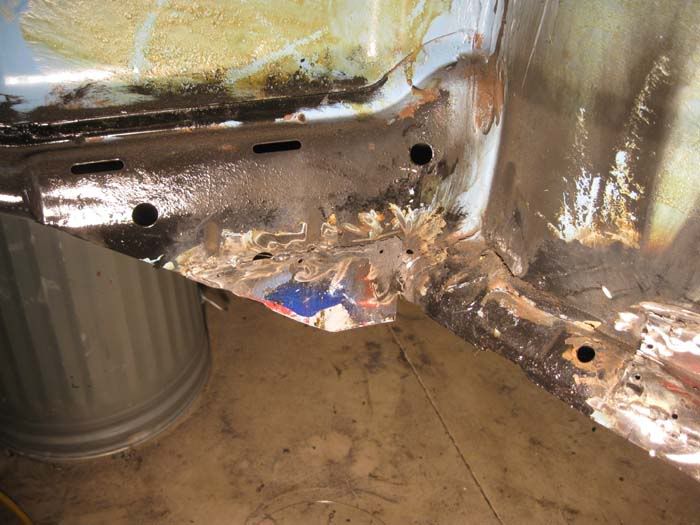

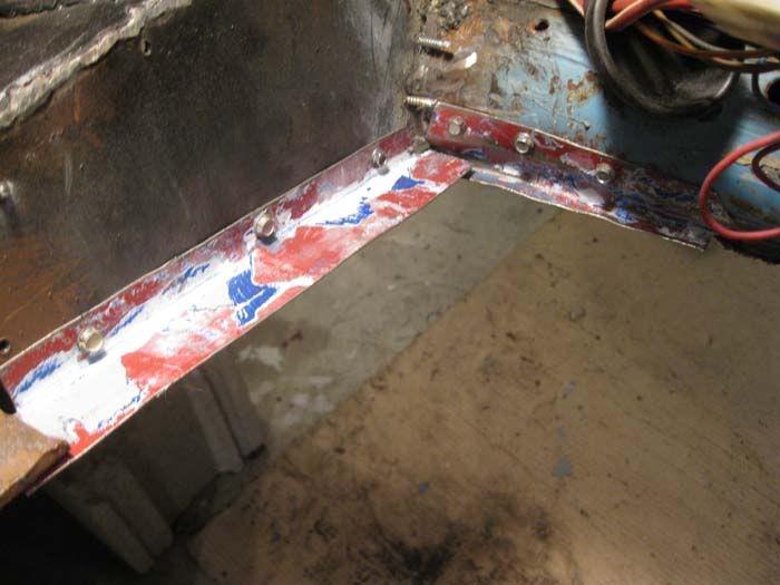

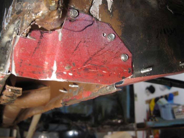

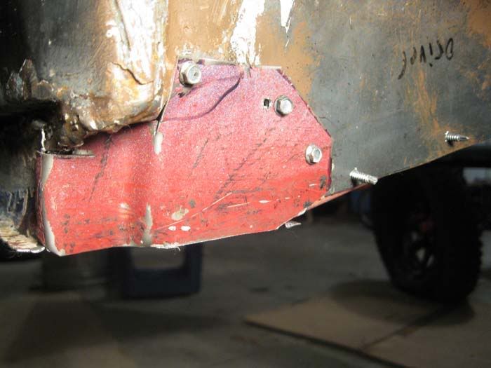

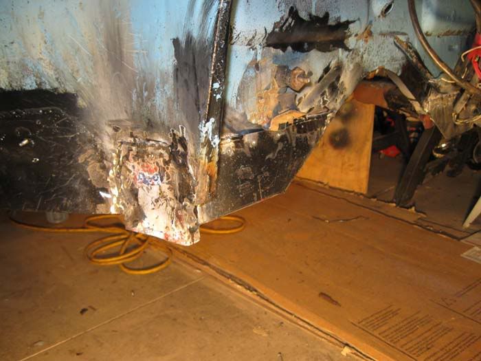

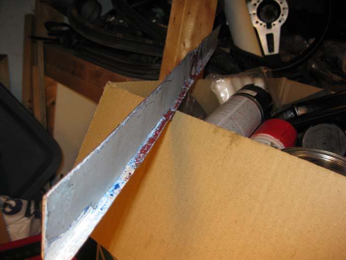

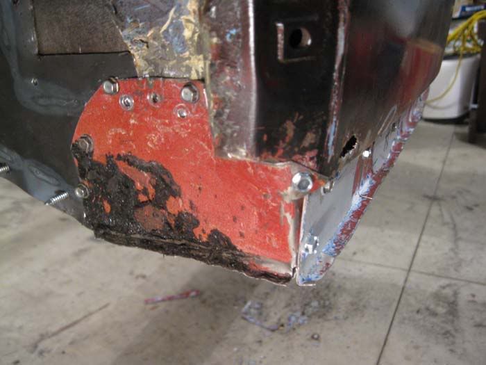

i had to cut the sides of the heater channels off cuz they were so rusted
i used vw body metal from the other car (door panels) for most of the patching that i have done.
i bent a 90* into the metal and then welded it onto the heater channel sides.
75 baja in pieces in the garage

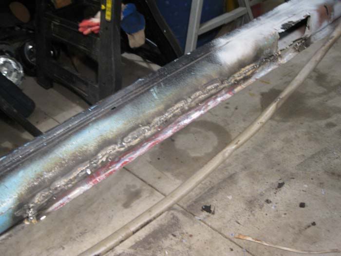

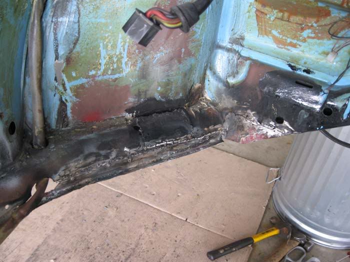

Posted: Sun Jan 24, 2010 05:12 PM

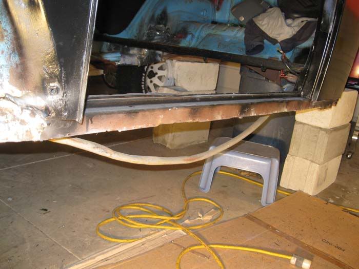

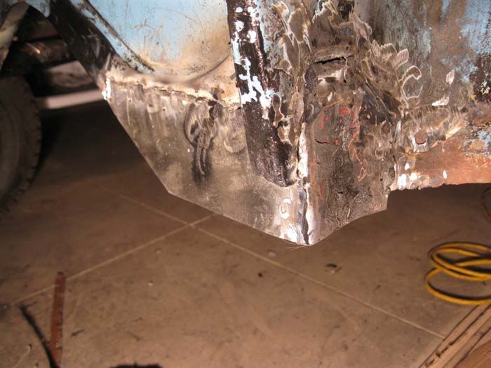

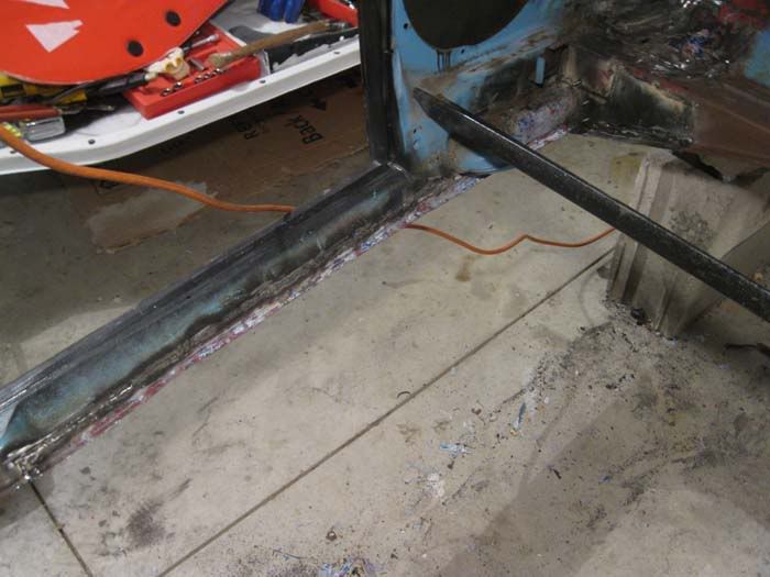

i welded it all up and it didnt turn out too bad but its a little rough.
it gets covered with herculiner anyway so it doesnt matter what it looks like.

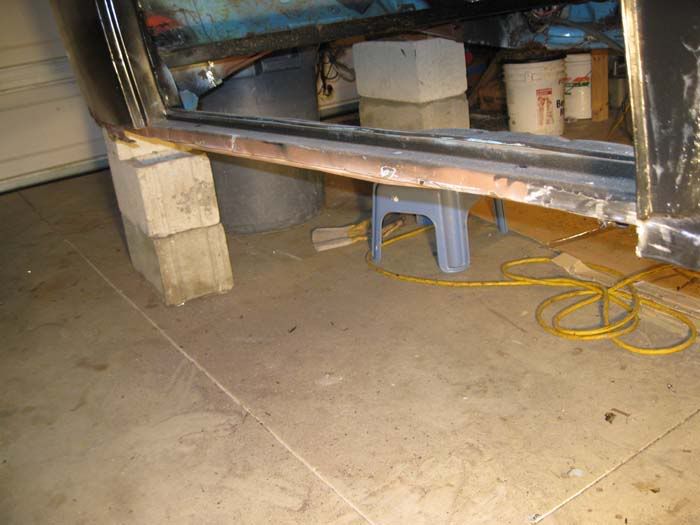

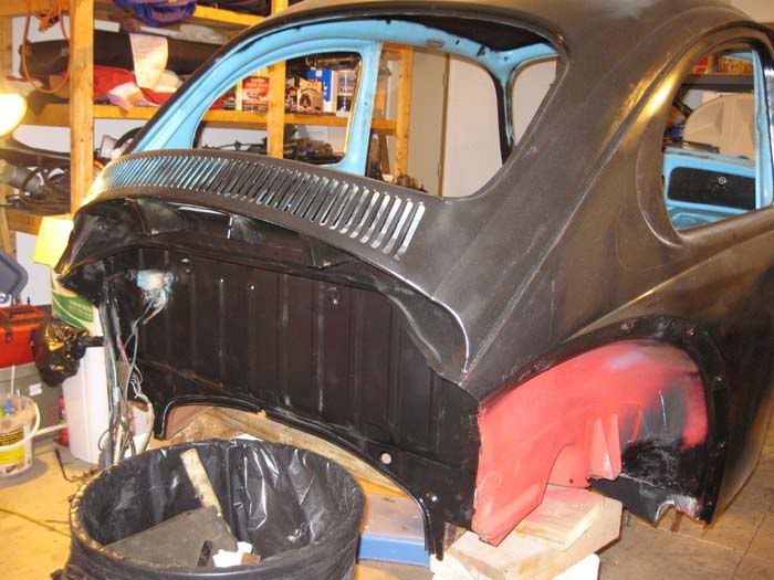

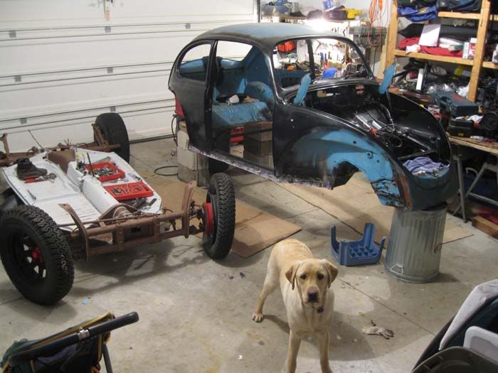

this is about what my car looks like right now.
with my fearsome guard dog Laughing
all these pictures were what it looked like as of a week ago.
ill take recent pictures of the completed heater channels and post them.
what do you guys think??

You're doin' good, man! Keep up the momentum!
IMAGE hint- when you copy and past the "img" line of script from photobucket, the image tags that photobucket has attached to it will suffice over here in the thread. It looks like you're adding another set from here- unnecessary. That's why all your pics have visible IMG tags next to them. Smile
Post Post subject: building my first baja.....i could use some advice
Posted: Sun Jan 24, 2010 10:48 PM
I think you have a toe in problem with your car. That will be a little hard on the tires, other than that great progress.
Laughing Laughing yea my steering box was slipping so i took it out. i have another one from my parts car that i need to put in.
the driver side inner-tube was popped but i think that other than that my tires are strait.
i have non-radial, tubed tires in the front....will that be a bad thing? not having radials? (in the back i do have radials tho)

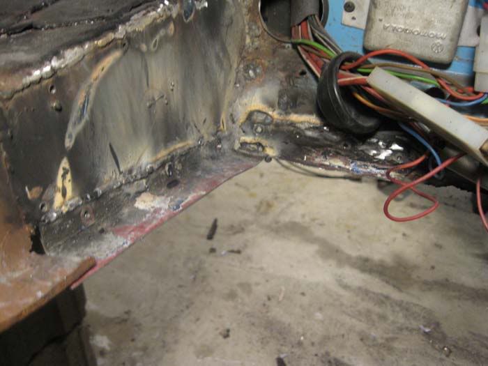

Posted: Sun Feb 07, 2010 03:34 AM
finished all the interior wleding and cleaned it up with a wire wheel, belt sander and palm sander.....WAY faster than hand sanding.
