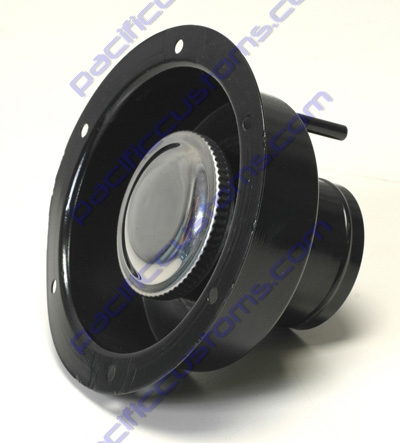

The ugly gas filler there ont eh right needs to be replaced with one that is more flush. Anyone know where I can find one? Looking through you guy's vehicles I see some people using a clear type of tubing for a gas tube down into the fuel cell. What type of tubing is it and where can it be purchased?

Post Post subject: New Baja Project Purchase- Help me ID some stuff
Posted: Sat Feb 19, 2011 09:34 AM
Flush fuel filler
www.pacificcustoms.com...020-3.html
The little tube to the top right in the photo actually goes at the bottom for a drain. Fuel spill/rain/etc. Hook a hose to go out the bottom of the body.

MojaveRacer208 - I'm all over that gas inlet. Perfect, Thanks.
