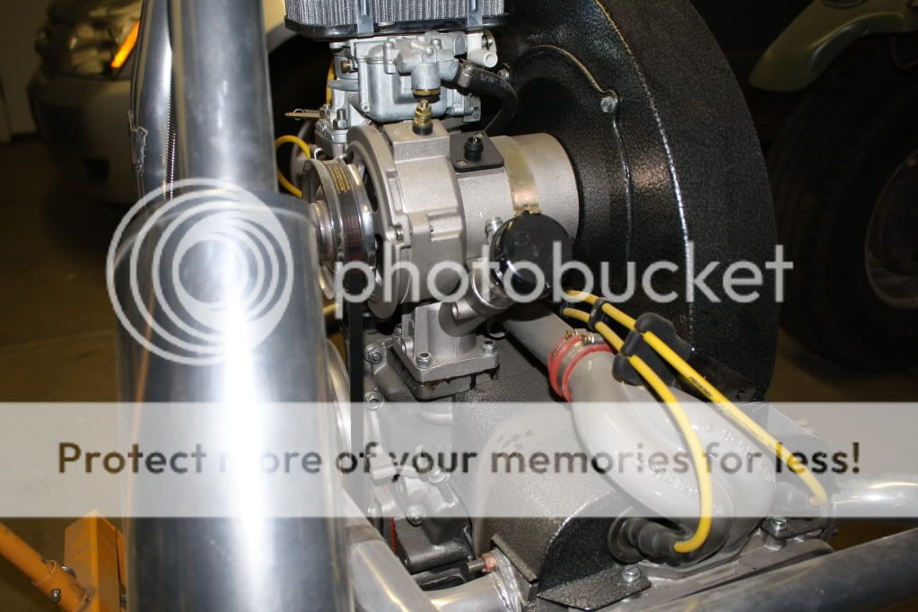

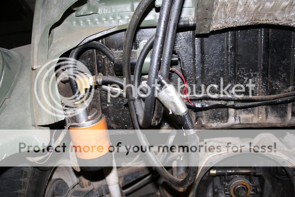

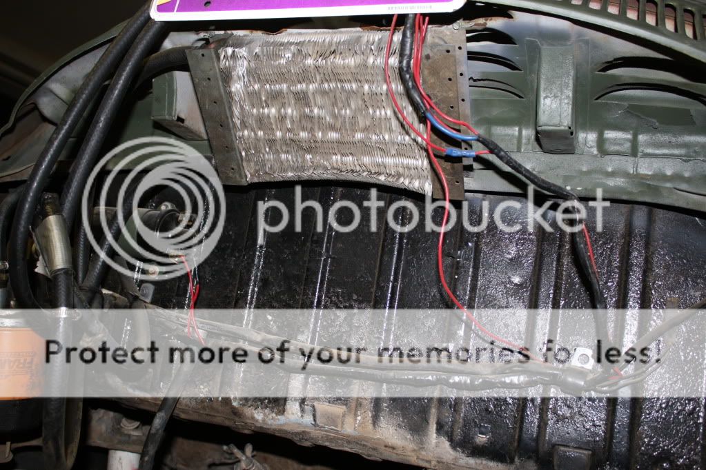

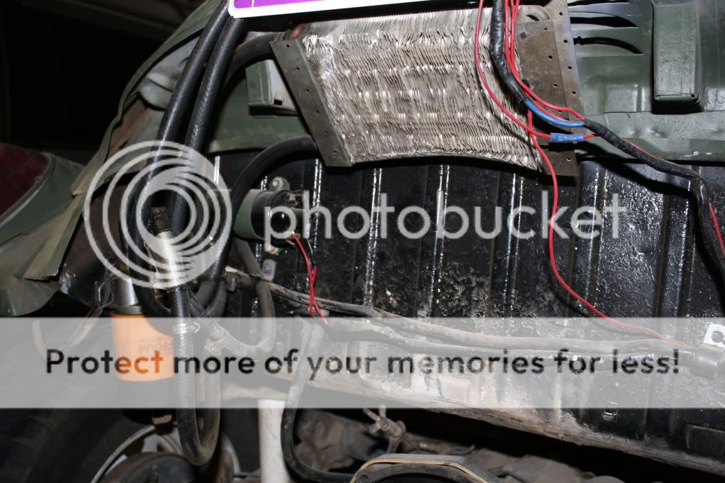

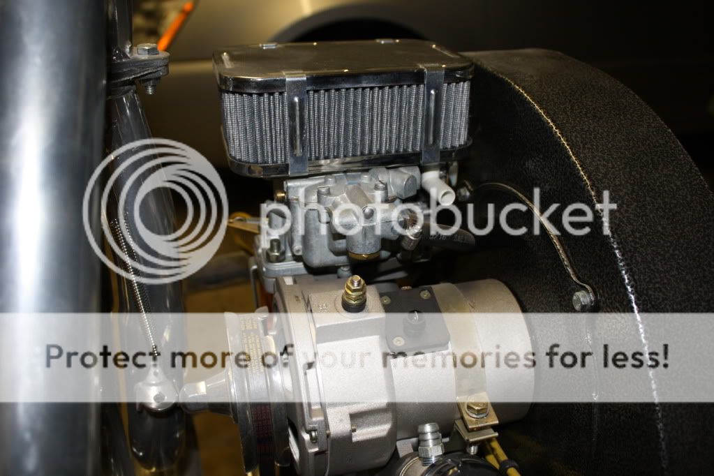

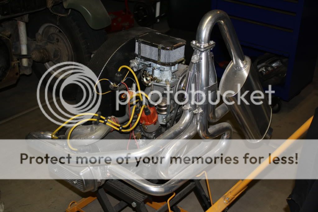

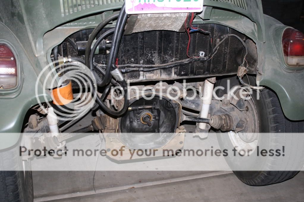

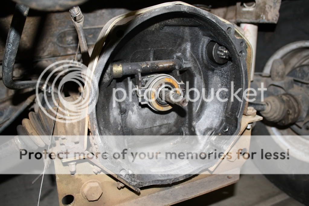

Thanks Richard. Ask and ye shall receive! Here are some picts from the back of my baja:

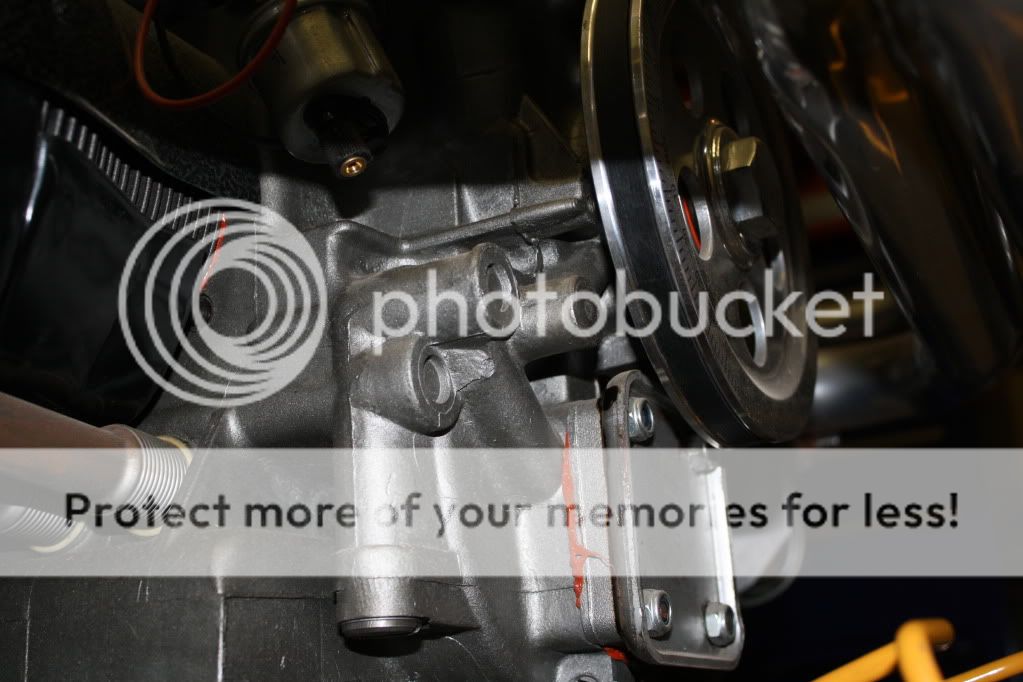

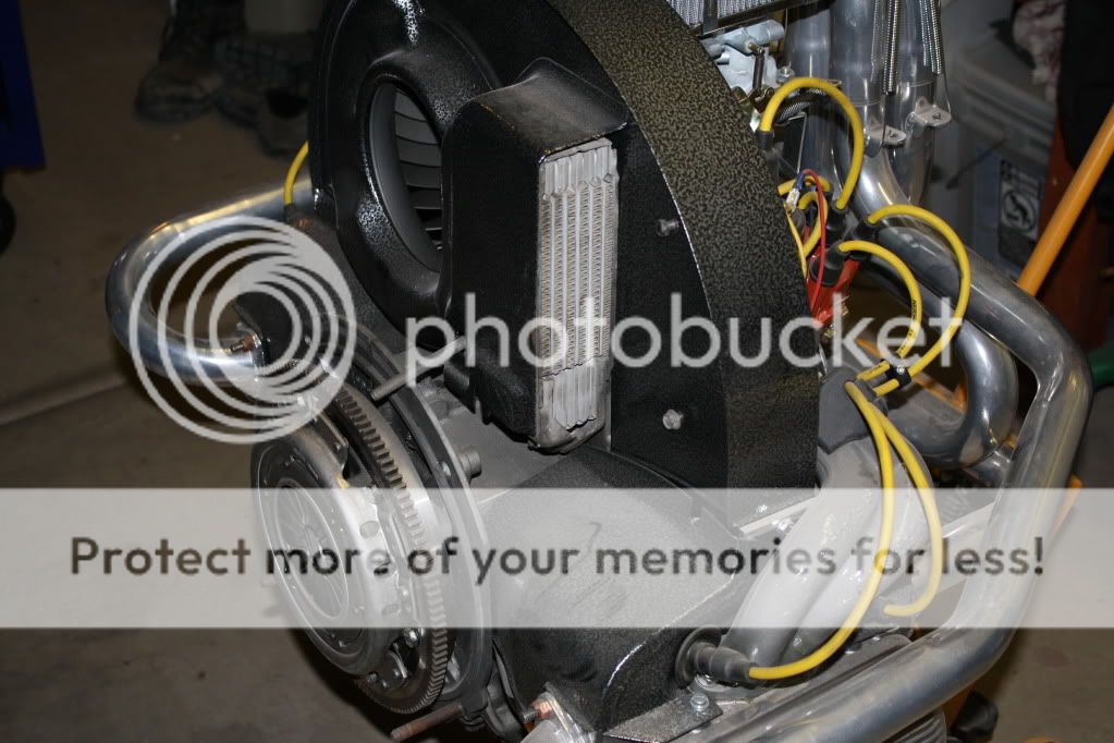

Here are some pictures of my motor:
Your car has an external oil cooler and a filter as I described. This is plumbed a little odd. If the hoses that go up by the window are simply loose ends stuck up there to keep them out of the way, the filter and cooler were plumbed separately. Maybe one "Full Flow" from the pump and the other from the top of the block. Could work, but regular "full flow" is better in most respects. "Full Flow" is when the oil comes out of the pump and straight to the filter and cooler, then back to the oil galley in the block or back to the pump body. It's called that because ALL of the oil goes thru the filter and cooler. Out the top of the case and back is only about 1/3 of the oil flow.
When I plumb these oil lines, I like to use "Flare" fittings on the end of the hoses and male flare fittings to the block and pump. This makes it EZ to remove lines to pull the engine or do other service. Regular "barbed" fittings are a PITA.
The cooler has been banged by the top of the fan shroud. This is no big deal so far, but might cause a leak later.
tdubs-83 wrote:
This shows that your Type 1 gearbox has the late style throwout bearing which slides on a sleeve. The bearing should get wiped clean before installing the engine and a thin smear of white grease on the tip and splines of the input shaft.
tdubs-83 wrote:
The clutch cable has some sort of spacer on it. That says something is wrong. I would take it out of there. should be just the wingnut on the end of the cable.
The fuel line has 3/8 oil line on it. It SHOULD be 1/4" /6mm low pressure fuel hose. That may be a protective sleeve over smaller fuel hose.
Good looking engine. Nice and clean.
There is a coil on the fan shroud and another on the firewall. A spare is good. But the wires have to be swapped when the need arises and they need to be long enough for that.
The Weber/Holley Progressive carb can be good for fuel economy while giving good performance when the pedal is pushed. But they have a bad rep for offroad use. Mainly fuel bowl vent problems.
tdubs-83 wrote:
You have a 36hp fan shroud (aftermarket) with the doghouse cooler. This is all good. Nice powder coat. No hookups for an external filter or cooler here.
The clutch is the later style which will be perfect for that throwout bearing in the trans! The engine case has the top captive nut for use with a doghouse. No room for a wrench in there. So you use a wrench only on the bolt head from the trans side.
The fan intake screen you have will not fit this shroud unfortunately. I have made a screen using 1/4" hardware cloth for mine. It sometimes gets pretty full of weed and brush stuff.
tdubs-83 wrote:
Looks like this engine hasn't been run yet. A full flow oil system would have a different cover on the pump. (plate held on with 4-studs with nuts) Full flow oil return would be back to the oil pump cover, or the upper oil galley plug would be drilled out and threaded with a fitting for a hose.
tdubs-83 wrote:
2-wire alternator has an internal voltage regulator. Make sure the car is wired for this. If there is a regulator under the left side of the back seat, it should be bypassed for this alternator. Not a big deal to do.
tdubs-83 wrote:
The white fitting on the aircleaner needs a 1/2" hose from the breather fitting by the oil filler cap.
tdubs-83 wrote:
I also have a Chirco Oil Pump For Spin On Filter 1970 & Earlier (Filter Not Included) [CPR115138] and a Chirco Air Intake Screen Chrome For Air Cooled VW Engines [CPR119106] that came with the motor but am not sure that they apply to this motor. Thoughts?
The engine that use to be on here had a turbo and the guy i got it from said that those hoses stuck behind the license plate went to the turbo. I had no idea what he was talking about since I have never messed with turbos.
I intend to make this Baja my daily driver with occasional off roading. Will this carb do well for me? Do I need to upgrade? If I wanted something more aggressive what would you recommend?
Can you elaborate on the fan intake screen? I just don't understand exactly what you are talking about and what I have to do to make it work.
This engine has ran 20 mins on an engine stand in a shop. It is full of oil though.
Would this be to replace the plate with the pump you recommended?
A turbo needs a lot of oil flow to cool it and keep the bearings from roasting from exhaust heat. So it was plumbed for that. So you will need to replumb the hoses a little.
Routing for fullflow without the turbo will be:
- from the pump to the filter inlet
- from the filter outlet to the top inlet of the cooler
- from the lower outlet of the cooler to the block inlet or pump inlet
The carb may work just fine for you. I say don't replace it unless it causes trouble.
Next step in carb would be dual Kadron with Kaddie Shack offroad float bowl vent. Next up from that would probably be a single Weber 40IDF or EMPI 40HPMX (essentially the same carb).
Ya gotta look real close to see the screen.
The screen for the Non-doghouse shroud will NOT fit on the doghouse shroud. Mine is made of 1/4" screen from a hardware store.
The pump I linked to is made for full flow with return through the pump cover and body. To install this sort of pump. you remove the existing pump entirely and replace it with one of these. For a "conventional" full flow system, the regular pump is used, but the outlet port of the pump body gets tapped and a plug threaded into the port. Then the pump is installed as usual but with a cover for full flow. In that case, the oil galley must be drilled and tapped for the return.
Now...Keep in mind that while I recommend a full flow oil system with a filter and an external oil cooler, this setup is definitely NOT necessary to operate the car. You could remove the cooler and filter from the firewall and bolt the engine in as it is. It would work fine.
There are more details and a world of more things for you to learn. I'm trying to keep it simple for you at this early stage and not overwhelm you with info you don't HAVE to know just yet. We can feed that out to you as you go. One doesn't have to pass his board exams for brain surgery before putting on their 1st bandaid. But it is good to know a little about cleaning and drying a minor cut and how to install a bandaid 1st.
