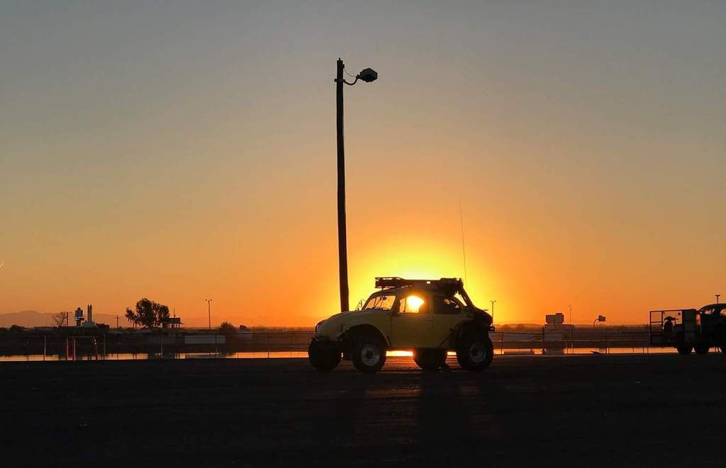

Hot vws posted this to facebook
[/img]
Post Post subject: My 69 project
Posted: Wed Mar 22, 2017 02:13 AM
Nice!
